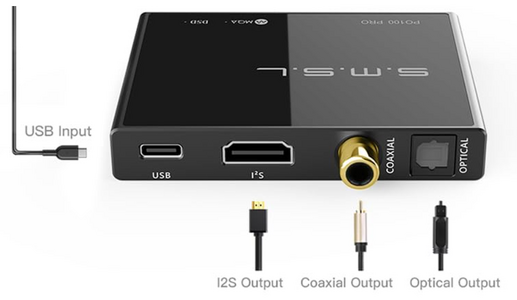

I think there is some merit to this, especially if you have a low end streamer but if you already have a decent setup, how much of a benefit would this bring?
Is it cost effective or like me, you like to tweak things to death! 🙂
I went over to Hoffman's forum, just picking up on other peoples comment.
I believe using anything but USB out from the Ultra you'll be using it's clock which totally defeats adding to the something else into the chain with to SMSL as the whole purpose is to use it's clock instead.
More than happy to be corrected if I'm wrong but I'm pretty sure I'm right.
Good point.
I figured all digital outs would be passthrough as long as the frequency and bit rate are supported for the selected output. If what you say is correct - and i have no reason to contradict you - then usb is preferred.
I think @TK421 confirmed that the SMSL only accepts usb input, so that problem is solved 🙃

I just went back and re-read your opening post, have you tried the Ultra with both RCA out using it's internal DAC vs Optical / Coax out into you amp to use it's DAC instead ..... I'd really give that a proper try to see which you prefer ...and more to the point if you hear any noticeable differences.

EDIT: And USB out into your Amp as I believe it accepts it????

I did a bit of research on jitter and clocking (because i like rabbit holes).
TLDR; the USB transport into a DAC is the cleanest.
  • USB is asynchronous, allowing the DAC to request data when it needs it. The DAC is the master clock, close to the D/A conversion processors. Lowest risk of jitter.
  • S/PDIF is synchronous, meaning the streamer "forces" data into the DAC and includes its own clock in the signal. The DAC must re-clock the incoming signal and essentially work harder to recover any jitter introduced.
    (Note: optical avoids electrical noise but has higher jitter risk than coaxial.)
The clock in a WiiM is considered quite good, but not high-end. Fortunately, modern DACs use various techniques (buffering, oversampling, PLL timing correction, ...) to re-clock and eliminate jitter before conversion to analog.
Now i want to play with my DAC inputs too, though my ears probably won't pick up the difference.
