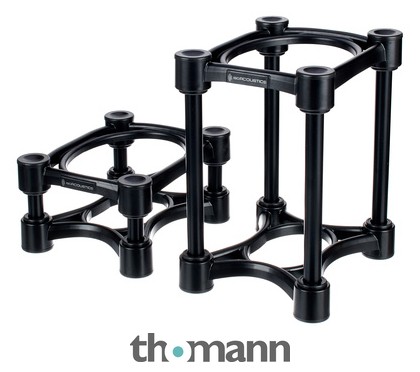

I've got them on IsoAcoustics Pucks on side cabinets - I'd love to get proper stands but it would mean getting rid of the furniture (not an option unfortunately).
Mabye get the small isoacoustics stands ?
