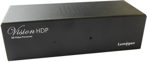

Good to see the direct tests here, and interesting....I presume with the Pioneer being a top end panel, it was more of a match, though I wonder if it would be the same with lower end LCD's...
The comparison test I would like to see, and hopefully the mag will do one day, is between the 'inbuilt' scalers in AVR's & TV's vs a separate dedicated 'outboard' scaler such as this :
......Worth the extra cost ?
