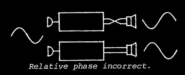

But if it reversed the polarity of both channels, then the channels would still be in phase with each other.
I can only say that the 'reverse' switch on my Harman Kardon amp swapped the channels.
You may have encountered it as absolute phase. I remember a Meridian CD player I owned having a phase or invert switch. It reverses phase of both channels so they stay in phase with each other. It is based on the idea that a more realistic sound arises if when say a bass drum is hit, both speakers cones move outwards. If they both move inwards then absolute phase is inverted. Historically some studios tended to invert phase, and others didn't. Some amplifiers invert too; Hifi News reviews mention this.

Yes and I can understand how the incorrect absolute phase could pass unnoticed.
What @My2Cents is describing in post #57 must be relative phase difference(s) - though I'd like to know just how any amp switch could cure them.
TBH I didn’t recognise that description. There is an extended explanation here:-
