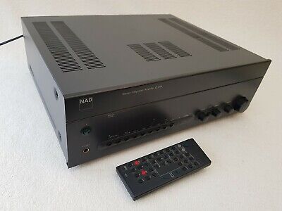

Deleted member 116933
This NAD would light the fire under the belly of those speakers
Plenty serviceable if needs be, id be truly happy with this amp.

Cheers millenia one much appreciated. I put a (perhaps cheeky) offer of £275 in which was declined. Its amazing how much the equipment holds its value really.
Perhaps a good quality power amp makes the most sense if a DAC which has USB input and decent quality Bluetooth is to be added. Its all very intriguing, trying not to be too impulsive and to figure out the best options.
In the mean time I have been given a loan of the NAD C 315BEE so I can check out what the power is like before buying. Got a lend of 2 5m lengths of oxygen free copper litz with gold plated connectors too with the option to buy for £20 if I like. Haven't been able to test it yet as waiting for leads to arrive so I can play music from my phone to test the power of the amp
