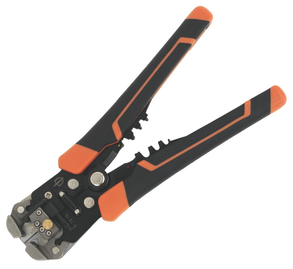

What do you use for stripping the outer casing on speaker wire?
I bought some of this recently
Which is meant to be pretty much the same as the van damme blue, stripping the inner red / whites is no problem and use a stripper similar to this

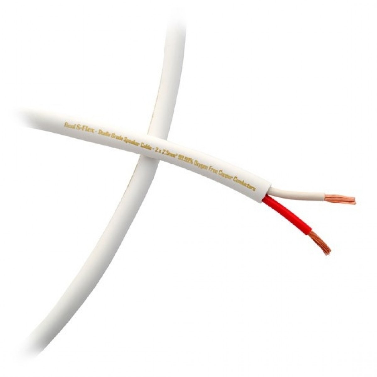

All of that style are 10AWG upwards and the outer casing's 7.5mm which is between 8 and 10awg and you can just force it in but it makes a complete dogs dinner of it.
I only tried these on the outers having several times tried using a sharp penknife and gently rolling the cable underneath to create a circle to pull away but on about 8 occasions I just nicked the smaller inner surround exposing the wire and that's being aware I'd done it the 1st couple of times and trying to be ultra careful for the rest.
If anybody knows a tool that does it without nicking the inner wires and makes a reasonably neat job I'b be interested to know what it is.

That stripper looks like one of those bite, grab and pull types. I've never liked them - seen too many of the dogs dinners you describe (where inner insulation and conductor strands suffer).

The outer sheaths are quite soft / rubbery, what I'm finding is I do a not too deep circle all the way round, grab hold of it with fingers and try and pull and it won't seperate. Go back cut "a smidge" deeper, part of it goes virtually right through but it stil won't pull apart, go back and cut maybe a small bit that's still hanging on in there ........ whooops .... too late.
I have been so careful doing this and it keeps happening, it wouldn't be any different with a Stanley to the knife I'm using.
I wonder if maybe the outer on this particular cable is just awkward as while it cuts really easily, it is quite "elasticated" and so unless it's cut right through ...... your fingers aren't strong enough to get a good enough purchase to pull the end off.

Try these, I've been using them for a couple of decades, a pair normally lasts me 4 or 5 years and I use them countiously day in day out at work. Bite the cable rotate and pull you'll get an excellent finish.
ref=ox_sc_saved_image_4
Good luck with those on the specific speaker cable in question here James.
(It's outer sheath needs a light touch - because all too soon you're into the cores insulation).
Hi Gary, I use them on multicore cables from flex to 16 core, every size from 0.5. to 1.5mm. Thats why I use them strips outer sheath and inner sheaths with the same pair only have to switch for crimping.
