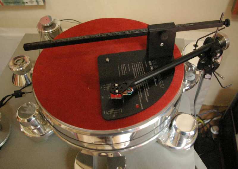

This is usually adjusted using an alignment protractor, which can be anything from a simple piece of printed card to an elaborate mechanical device like this...
I am the proud owner of that exact elaborate mechanical device *biggrin* Works brilliantly.
