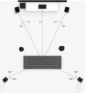

Due to the room configuration and previous wiring (and WAF prohibiting trailing speaker cable in the middle of the floor), I have speakers positioned right at the rear of the room, but none beside the seating position. I also have in-ceiling speakers positioned left and right of the seating position. In other words, I would have a classic 7.0.2 speaker setup with top-middle speakers except that I'm missing the surround-left and surround-right speakers. ie. it's not really 5.0.2 because I have rear channels instead of properly positioned surrounds.
My question is, how should I connect and configure this? Should I connect the in-ceiling speakers as surround-left and surround-right? They are well-positioned to the surround-left and surround-right except for the fact they are in the ceiling. Can I rely on room-correction to solve this? Or should I connect the in-ceiling speakers to the height channel, and leave the surround-LR socket unconnected, and hope the AMP notices that I'm missing those speakers and can correct for it? Or should I use the rear speakers as surround speakers, even though they're 4m to the rear, when the front speakers are less than 2m in front of the seating position?
My old receiver has just broken, and I'm about to buy a replacement (probably a Onkyo TX-RZ30 unless you talk me out of it), so if there's a room connection option I should be looking for in a purchase, please let me know.

Personally, given the speakers are in the ceiling, I would certainly utilise them as height speakers and not rear side speakers. (If you want to give it the time, you could try it both ways and see what you prefer).
I would use the rear speakers as exactly that, rear speakers.
When you go through the set-up process you should be able to tell the amp what speakers are connected and/or the calibration will pick this up automatically.
The question was about whether to the top middle speakers as surrounds and the rears as rears, or the top middle as height and the rears as surrounds.
Since I wrote this, I've just read a blog at REL that said that ceiling speakers can be fine as surrounds, so I'm going to try that. Of course, the REL blog argued the case for having three subwoofers, but as the saying goes "they would, wouldn't they?"!

5.1 has surrounds not rears.
Back wall sounds like the wrong placement. Show me a floor plan.
Ceiling is for Dolby atmos and dts x and under no circumstances do they ever get used for any ear level speakers.
Answer to question is surrounds go into surrounds/sides terminal.
Ceiling speakers into height/rear surrounds (assignable in select models)
