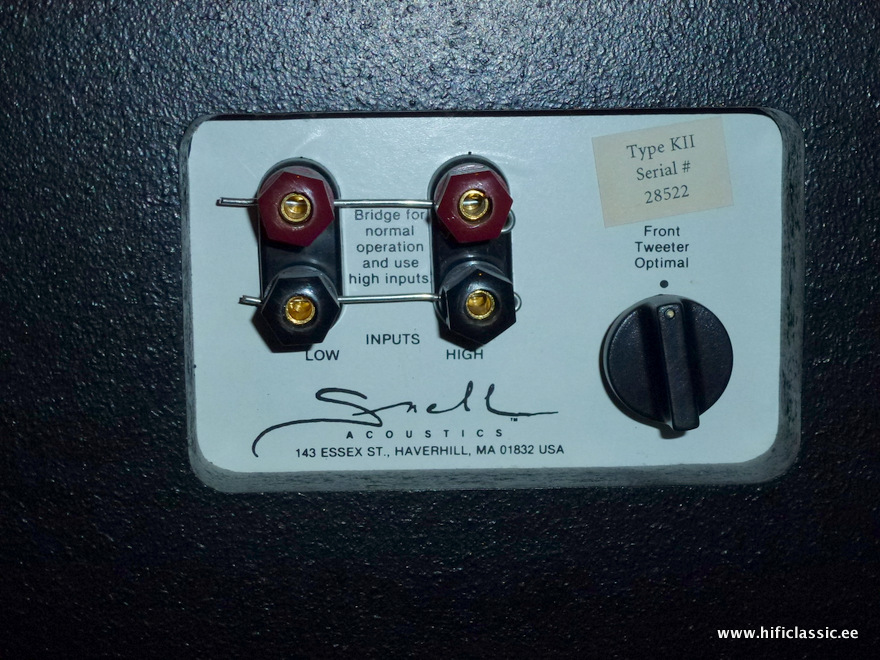

Bi-Amp Speakers with Brass Jumpers
Those brass jumpers are just plain nasty. Get your local hifi shoppe to make you up some 6 inch to foot long jumpers using the same speaker cable as your main runs or just connect the terminals using the screw-down parts of the terminals (assuming you can get two cable ends into whichever terminals you also use for your amp-to--speaker runs). The sound will improve immensley. Remember the manufacturer built these speakers to be bi-wired or bi-amped and the jumpers are just there so the speakers work without bi-amping/wiring, not for optimal sound quality at all.
Tip to avoid loosing the brass jumpers is to just loosen the speaker terminals, rotate the brass jumpers out of one set of ends so they're no longer making contact and re-tighten the screw-downs. Them you or your Memsahib won't throw them out or "put them away somewhere safe" - never to be seen again. BTDT.
Wierdly, some people (Linn I tink) used to recommend running the jumpers diagonally, i.e. HF+ to LF- and HF- to LF+, which runs the bass and treble anti-phase. You can experiment and decide for yourself. Not sure if you'll b*gger the crossover circuits in the process though, so proceed with caution.

Van Damme 4mm copper, soldered, cheap and pretty.
The sound won't change very much at all by using bits of wire, but it will definitely be worse than using the flat plate jumpers.
How could it possibly get better?

so using speaker wire to replace brass jumpers that can take maybe 200+amps before they blow improves the sound. No wonder some of you lot are easy prey for snakeoil salesmen. You almost deserve to be conned out of your money. But hey it's your money, who am I to judge.

That might be true if they were solid ‘brass’ but mine are very thin plastic coated in a layer of something gold coloured (might be gold but it’s not clear).
When I bought my speakers they arrived with only one bridge. Three others had gone missing. So as a stop-gap (whilst new bridges were ordered) I bought my Van Damme jumpers.
The other bridges eventually turned up at the dealer’s, discovered inside some other ported enclosures when they were found to rattle if moved.
It seems a customer’s child had unscrewed some and ‘posted’ them in the convenient holes.
The replacement bridges (very, very delicate) now live in a small card box until such time as I sell the speakers. They could bend by supporting their own weight I think!
I am not bothered about comparing them. I am sure - despite their fragility - they wouldn’t sound much different but the Van Damme jumpers look and feel far more secure.

200 amps into 8 ohms is 320 kilowatts. If your speakers can take that, if your house has its own power station, stick with the brass jumpers. Otherwise try speaker wire jumpers. Or are your speakers hooked up to your amp with straightened out coathangers or flat twin and earth too?

Most of those "brass" jumpers are probably brass or cadmium plated steel.
And since iron and steel have six times the resistivity of copper, not to mention the phase changes caused by the different reactances... From there on it gets really testical...
A short, flat jumper plate will have lower resistance than a jumper cable.
I can well imagine you don't want to "mention phase changes caused by the different reactances" - as I have no idea what you are talking about.
Perhaps you could share your thinking on this?

FWIW I just pass the cable through the low connector, de-nuding enough cable for it to clamp down and terminate it on the high connector. Something about using one continuous piece of wire makes sense to me. It doesn't really sound a world different to other configurations.
