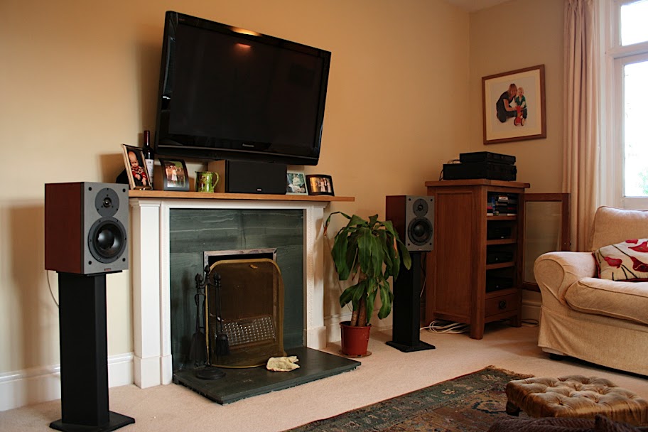

The old amp is in the pic - this worked OK...
