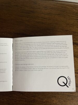

Ortofon recommends against use of solvent cleaners as it can damage the cartridge. Anyone have an opinion or experience with this?

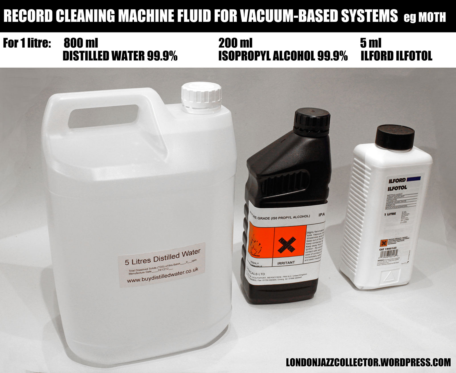

They generally are, if not nothing to worry too much about. Even the home brew fluid used by many on here contains IPA, basically as a de-greaser/drying agent.

Point taken, but the package insert with Quintet does say to avoid cleaning with solvent “…either the record surface or stylus”
That’s slightly different wording for the MC model then. Probably wise, as it’s impossible to know if user will splash a huge amount on, rather than a tiny drop on the tip of a brush. It’s if it tracks back to the suspension that trouble is possible.
FWIW I used isopropyl for years with never a problem, and back in the day I had an Ortofon M 20 FL Super which I’m sure I treated similarly to ADC, Shure, Satin, Grado, Goldring etc.
Reactions: Al ears and DougK1
It’s not record cleaner they caution against, it’s stylus cleaning fluid, in particular isopropyl alchohol.
See page 6 (numbered 10) here…https://ortofon.com/cdn/shop/files/...-b4bf-b4af2035fa62.pdf?v=17811384605696627725

There is a raging debate on the optimum ratio of pure IPA and deionised / distilled water.
There may be but I am not about to change my solution that has served me well for years....
Not the same solution I should add but same formula...

I'm sure you're aware of the fire risk of pure IPA, so probably best not to use it undiluted in your tank ( If that was what you intended !? ). The vapour is not good to breath either.
A solution should degrease your vinyl just fine, perhaps approx 20% strength, you could also add a very small dash of detergent.
I use Vinyl Shelter fluid which they state contains 20% isopropanol, I find this product works well as a record cleaner.
Come to think of it, a decent quality windscreen washer fluid with IPA in it should also work well, you may need to experiment with concentrations though.
