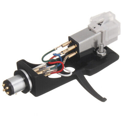

While I am looking for a headshell I notice that some are many times more in price than others. Why is this is my question?

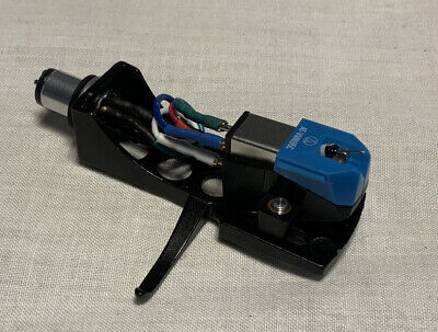

In fact I can buy a headshell with a cartridge and stylus for the same money as a low cost headshell. It makes me think I might as well buy something like this just for the headshell and maybe get a AT-VM95E later.
Or even this!!
Cheap plastic ones like that one from eBay might not be the way to go, unless you are broke..... In which case vinyl isn't for you. 🙂
The headshell with mounted AT works a treat. I've had one for the 95C and then some time ago, I think one for the 95ML when I used to have it and the headsheel was fine. Yes, you can of course spend through the nose for a headshell, but then again, as you rightly pointed out, people get fleeced all the time in hifi. Maybe you did too. 😉
