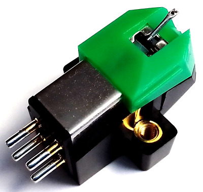

Without going overboard on price what cartridge would you suggest for it please? It has a Shure EJT2 on it.

Have a look at the Audio Technica AT-VM95 range John. There's the excellent VM-95C at about £35, which is the much unheralded star of the range and one of the best bargains in hifi IMO. Or, if you've a bit more, then the microline variant (VM-95ML) will set you back about £150.
This looks "in budget" so I have put it on my watch list to buy in month or two.

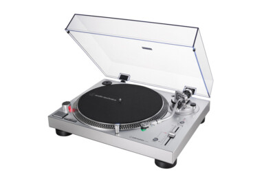

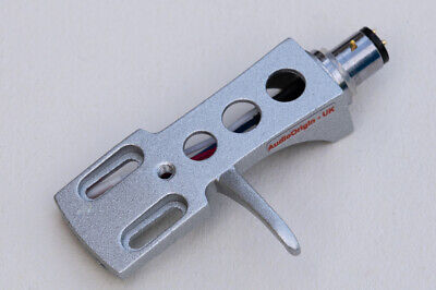

Also, in a few months, I want to get another headshell for it and had this in my sights.
In passing, I liked this TT but it is out of my price range for a "second" turntable.
Audio-Technica ATLP120XUSB

I've had the VM95E as well as the ML and the C but felt of the two at the entry level end, the Conical cartridge had a bit more about it when it came to the music overall. Can't really go wrong with either though. Happy listening!
