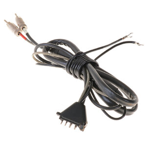

I recently inherited a Technics SL120 turntable from 1974 which is in great condition but there seems to be an issue with the output, which is quiet and very lacking in low end. The tonearm has an old SME connector on it, and it looks like it has seen better days - so it uses a cable like in the picture below to connect the tonearm to the amp. I think this cable is the problem, but getting a new one seems to be well nigh impossible and I'm wondering if in fact I can just replace the entire tonearm with one which has a more modern connection. Is this even possible, or do I have to use one with a connector like this? Am I even going the right way about solving this problem?

that's a standard socket for older SME arms.
Either he's plugged into wrong sockets on the amp or it's possibly a MC cartridge.

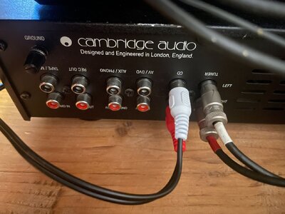

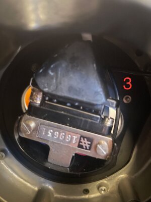

Hi everyone - thanks very much for all your thoughts. I wondered about the amp input being an issue so checked the same inputs with a different device - no issues there, but I am attaching a pic to show how I have it connected up to the amp. I have tried to capture some more pics too showing the plug on the bottom of the tonearm, though it is a little tricky to see. My issue is I'm not technically capable of resoldering cables onto a different output from the tonearm or anything like that, I'm just wondering if I can do a wholesale replacement of the tonearm, cartridge and all to get a more up to date connection. I don't really know how to isolate the problem, that's my issue.
The images are as follows:
Image marked "1" - bottom of the tonearm from under the turntable, phono cable plug taken out
Image marked "2" - as above but plug to phono cables showing
Image marked "3" - as above but phono cable plugged into tonearm

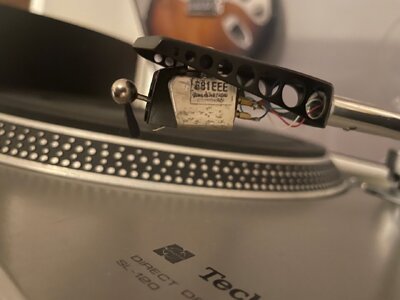

I've also added pics of the input into the amp (turntable is plugged into the "tuner" input), the whole tonearm and the cartridge. Happy to add any more if needed. Thanks so much for the help!
NickIMG_1002 (1).jpgIMG_1004 (1).jpgIMG_1005 (1).jpgIMG_1006 (1).jpgIMG_1007 (1).jpgIMG_1008 (1).jpg
The turntable has to be plugged into the Phono / Aux sock not Tuner
There's a chance the amp doesn't have an inbuilt phono preamp although there's a possibility it does looking at the earth connection.
What exactly is that amp and what is the cartridge fitted? These are the answers we need to help you.
Don't need irrelevant photos just answers.
There is probably nothing wrong at the turntable end except maybe a good squirt of contact cleaner.

Hi - the amp is a Cambridge Audio A1 integrated amp. I have tried plugging into the aux/phono inout but have the same issue. I'm sorry but I'm not sure what the cartridge is, but at the risk of another irrelevant photo, here's a pic!! I understand what you are saying about a separate preamp though. Makes sense!
The cartridge is a Stanton 681 EEE moving magnet and is probably in dire need of replacement.
This might be the cause of issues and it should be replaced.
Failing this you may need to add an external phono preamp but only if there is an issue with the internal one.
You also need to connect those earth wires to the back of the amplifier.
My money is on the cartridge itself.
