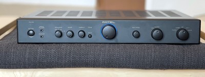

Hi
I'm running B&W 607s off a Rotel RA931 connected to a desktop computer in my study. I use this set-up for listening to (mainly) rock music and all is fine.
Quite happy until about a year ago when the right channel stopped working intermittently. It's clearly an issue with the RA931 and it's getting more frequent. I've removed the cover, wiggled everything I can see, can't see anything obvious and decided to replace the amp.

I have the same problem with my Rotel 931, I found it keeps blowing the fuse of one of the channels. Its in my loft and will give it service at some point. bad capacitor i guess shorting it out.

The RA931 has an inherent design flaw. The heatsink on the underside is too small and doesnt disipate heat very well if the amplifier is used hard.
Its a very simple amplifier and you probably have one of the large capacitors near the PSU giving up which often caused this kind of fault. its probably time to replace them anyway so upgrade them a little with some 10,000uF/50V versions if you deided to keep it.
