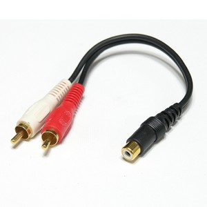

So it looks like what I need is a female to 2 phono autolead like this one:
which is the same as the one I already bought and it didn't work. Maybe I bought the wrong one but it looks just the same.
With the new lead I bought I tried to connect the jack to that green bit where it says "phones" in case it worked but it didn't.

The twin rca phono plugs should connect to the output of your phono pre-amp, the single jack to one of the input sockets on the rear of the amp.
Select the input you have chosen and you should be good to go.
Nov 19, 2016
Yep.... When I said I wasn't tech savy I really meant it. It works!! Thanks guys.
