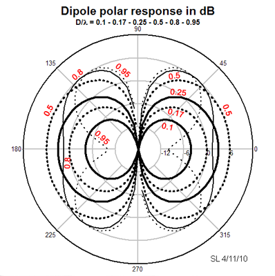

At what frequency though? 600Hz is not bass. Did you check the graph posted by Dave?

The near omni-directional radiation of bass frequencies is not caused by the vibration of the enclosure but primarily by diffraction, ie the bass energy is 'diffracted' around the speaker, hence the all round response. The bass frequencies produced by the port are also refracted in the same way as the frequencies produced by the drivers, however any port noise at higher frequencies is more directional, so rear ports are less noisy at the listening position.
Of course as a user of Martin Logan hybrids, you will be very aware of how the omnidirectional response of your bass enclosure is carefully integrated with the 'figure of eight' radiating characteristics of your dipole panels.

Anyway, my point remains: if you generate sound inside a box and then make a hole in the box, more sound will come out, and it'll come out through the hole.
....and be defracted around the cabinet in line with the laws of physics.
Take any box loudpreaker or woofer enclosure with whayever drive units etc, you want, it doesn't matter, the dispersion is, effectively, spherical at bass frequencies. At higher frequencies the diffraction effects are not an issue and the dispersion patern simply becomes a function of diaphragm size.
