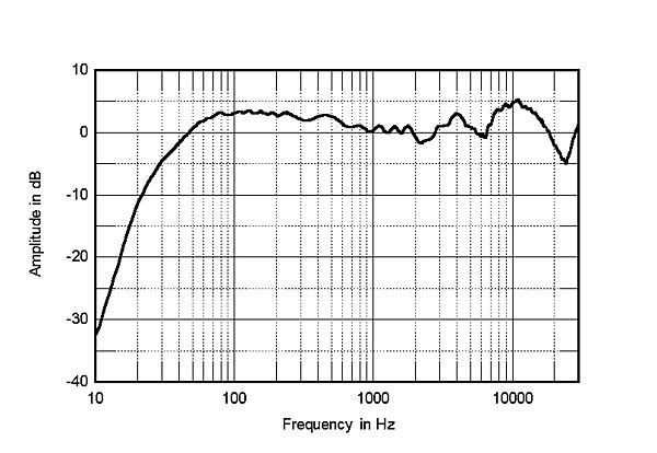

Do you really think a pair oif kef reference 3 can play good bass under 70-80 hz ? Ratyed at 43Hz - 35kHz (±3dB)
We all know that in many cases a flat frequency responce can sound borring even when most records are not neutral recorded
2022-01-24 02_22_03-SoundStageNetwork.com _ SoundStage.com - NRC Measurements_ KEF Reference 3...png
Bowers & Wilkins 802 D3 rated frequency responce 17Hz–28kHz, ±3dB
Does that seem 17Hz–28kHz, ±3dB to you ?
-5 db at 30m hz ? - 7-8 db at 30 hz ? What do you think ?
