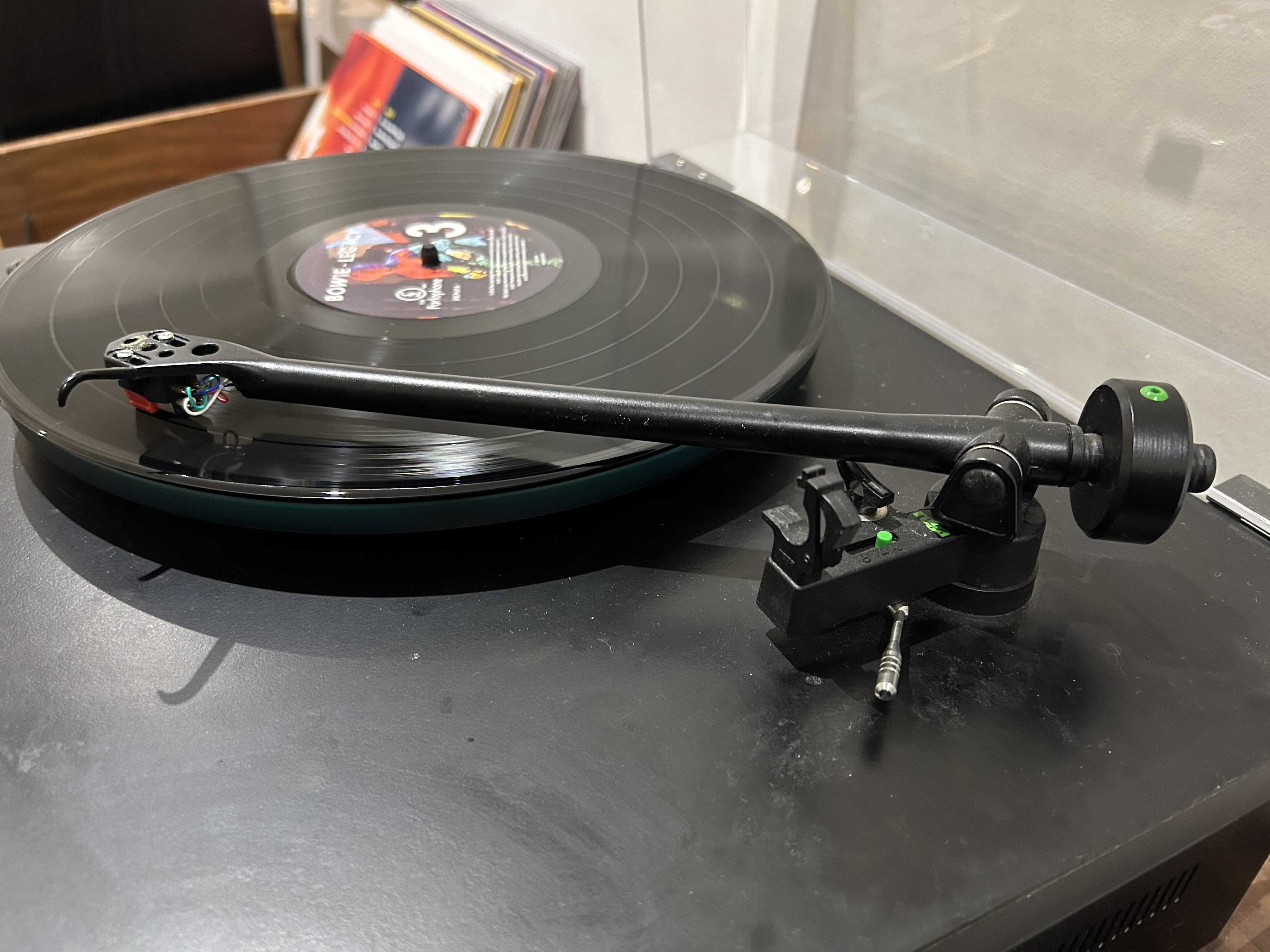

Thanks for the extra info! I’m actually not sure what arm it is. When I put the anti-skate to full, that solved the low volume issue.
On new vinyl, playback is generally pretty excellent. The odd new vinyl has crackles/clicks in the right channel though, and noise is exasperated on older/dirty records. Markedly worse than on the left channel.
In case it helps:
Reactions: nopiano
Ok, that’s the Rega arm alright. Almost identical to the one on my Michell, down to the green pip!
I‘m bothered about the low volume. Antiskating cannot change that at all. It merely helps the cartridge traverse the record without too much pull inwards (a function of the angled headshell). Can you experiment by sliding the little green antiskate marker towards you, so it’s set at 0 - zero? It should still play fine, but just to see if the volume changes. If it does there may be a dodgy connection in the headshell.

Yep, there’s a definite drop. No more than 1db or so by my ears, ie not huge but enough to let the vocals move slightly to the left & loss of clarity for right-panned instruments.

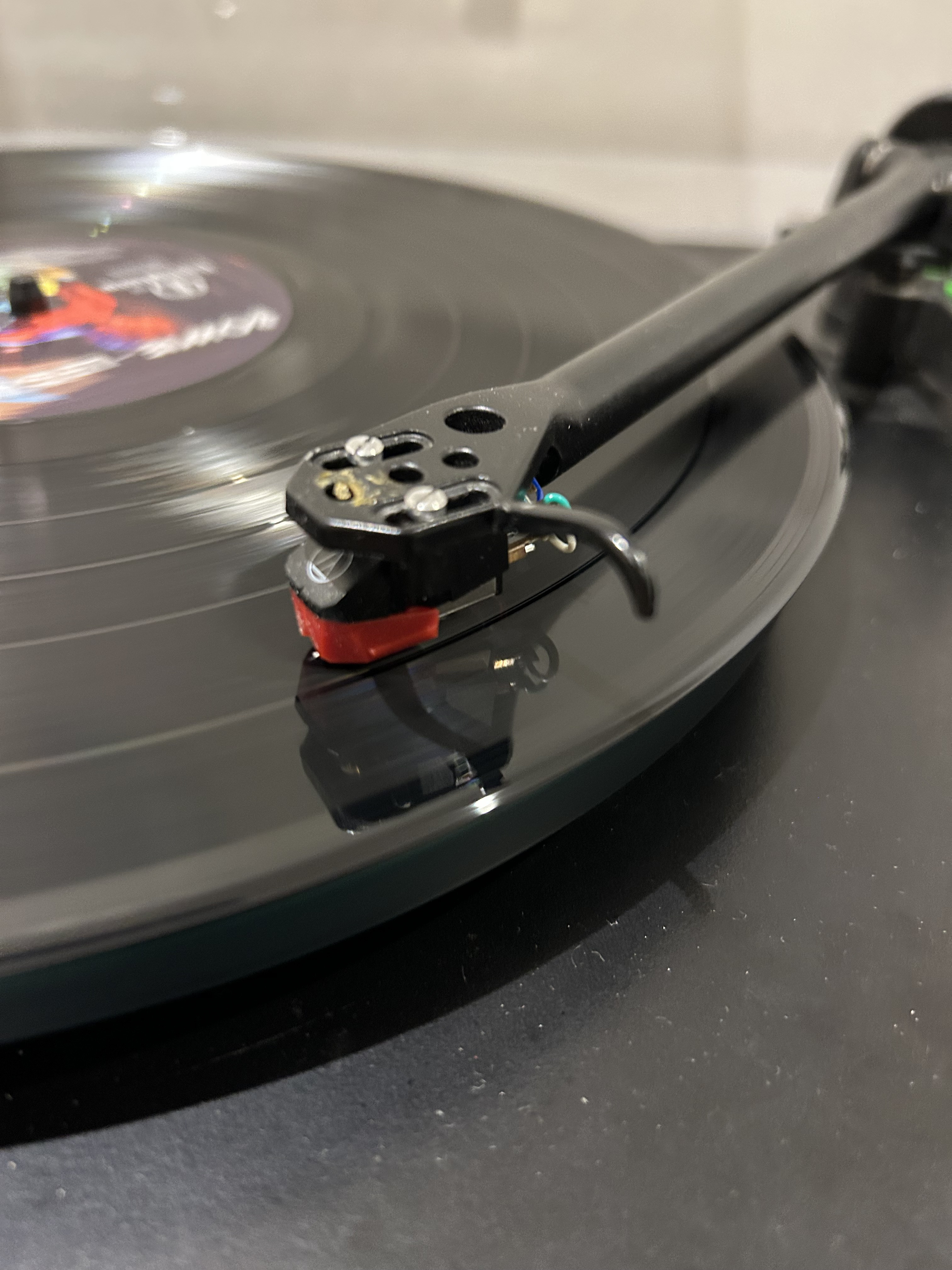

Looking at a close up of the cartridge wiring they don't seem to be in the right order. I have a AT head shell with cartridge came as a complete unit from AT and his wiring is not the same.IMG-0592.jpg372316789_979486623164987_6597648319655677845_n.jpg
Looking at a close up of the cartridge wiring they don't seem to be in the right order. I have a AT head shell with cartridge came as a complete unit from AT and his wiring is not the same.View attachment 5170View attachment 5171
Sorry, having trouble seeing that on my device.
If he hasn't managed to work out the colour coding and get that right then that's certainly a potential issue.
He really is going to have to work backwards from the cartridge and check all wiring and answer va few more questions before I waste any more time here.
