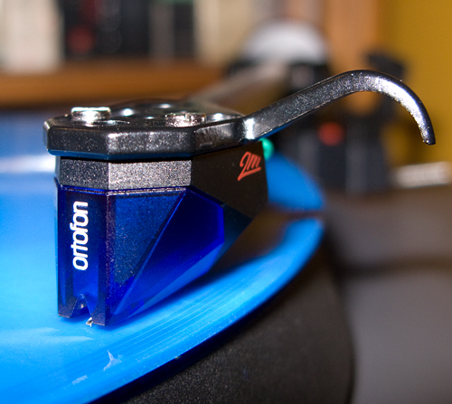

If you do upgrade from Ortofon red to blue then just buy the blue stylus replacement and stick it in the 'red' cartridge body. You can keep the red stylus as a 'spare'.
That's what I did all those years ago (around 2008) ...
(Note red body and blue stylus on my circa 2008 Rega P2/RB250.)

The op has a OM10 and the 2M stylus red or blue would not work with it anyway different cartridge altogether. I have the 2M red and I sent an email to a reputable dealer who is well known on this forum and he told me in all honesty that the upgrade from red to blue stylus would be a very subtle difference it put me off the idea a bit given the price of the stylus.
I went from om10 to 2m blue and the difference was night and day,best sound per pound upgrade I've ever made.Although it will depend on whether the rest of the op's system is able to resolve the extra performance from the upgraded cart whatever it may be.I already had good amplification and speakers in place to absorb the upgrade.
