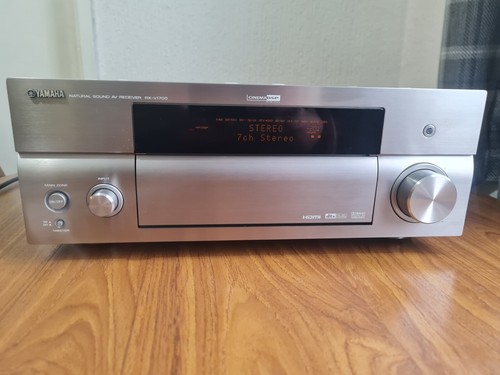

This is all becoming far to difficult. If you’re happy with them, then fine have at it no need to replace the speakers.
Any amp will run them forget about the watts. You state you want cd capability, most have a dvd player and or a Blu-ray player in the house save some money use that.
You’ll quite happily get an amp for well under 500 quid with the all connectivity you want and then some especially second hand.
here you go job done 74quid, even has a phono stage.
Spend the rest on a cd player or dvd player of which there are plenty on the bay starting as little as a 5er
No modern 500quid midi system will beat the sound or the functionality of this.
You’ll even have money left for speakers if you want, mission 701’s 702 60-100quid all day. Somthing newer? Mission m73 m74 series same prices kef q line just watch out for crumpled tweeters. You may just to travel and pick them up or get a man in a van to do.
hope that helps

Thanks for the suggestions. Helpful.
