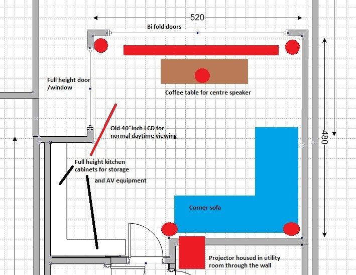

Hi BigBoss,
I'm new to all this and basically I'm looking at building an extension, roughly 5m x 5m. I was looking at the KEF T305, MA Soundframes and then moved onto the KEF Ci range and now onto the MA WT range as I delved deeper into the speaker world. Did you consider any of the ones I mentioned and if so why you ended up with the WT range? I heard a demo of the KEF T205 and the rear speakers were struggling as I asked the sales guy to crank it up. I think the T305 may do the job, but would like to play it safe and get it right 1st time. I'm guessing you've done your homework and basically trying to save myself some time as I really don't know much about speakers !!
One problem I have is that the projector will come down in front of bi-fold doors and I will have to house the centre speaker in a coffee table of some sort and the KEF Ci380QT would solve this problem but I'm not sure how it would sound firing down from the ceiling.
Any input and advice on how you came to choose your speakers would be most appreciated, and I will follow your build to see how your system comes along !!!

Where is the projector screen? In front of the bifold doors? Can you post some pictures?
This is my mockup of the planned extension. Room measurements are pretty accurate apart from the sofa etc. First and foremost, this is a family room, the cinema is a bonus. I know lighting will be a issue so a normal old TV is there for day time use. Having read your threads, i also know the sofa may not be in the ideal position. I think I've shortlisted down to KEF T305 Monitor Audio Sound frame and Monitor Audio WTxxx. Did you consider the sound frames? apart from price do you know if there is much difference in performance? I've not decided on projector or srceen yet, but SSAV are doing the Denon x4100 cheap.

SoundFrames are astonishing for their size when I demoed them. I can't comment on comparison performance as I haven't heard my WT speakers yet. You'll have to wait 2 weeks for that, when my system will be ready.
With regards to the surround speakers, if you move the right speaker towards the other end of your sofa, it will encompass everyone sitting in the corner sofa.
That room will be quite bright. I would recommend Draper ReAct 2.1 screen which is ideal for bright rooms as it rejects ambient light.
What's your budget for the projector? I've bought the Sony HW40ES, which is the best sub £2000 projector currently available.

Technically I see what you mean about moving the right surround speaker, but I'm not sure it'll "look" right. I'm not overly fussed about it as I definately know which seat i will be on.
I'm afraid the speakers are the only things we have in common, Projector I'm hoping to spend 1k, sub, i was recommended the REL Acoustics S2 and screen no idea yet. Feel free to give me your recommendations though....
Realistically, I am only going to be using the setup in the evenings due to the light and am happy to do so. Thats why i have a 10+ year old Sony LCD in there !! I'll have a look at the sub and screen you mentioned tonight but the proector is out of my price range and I think the screen will be too.
