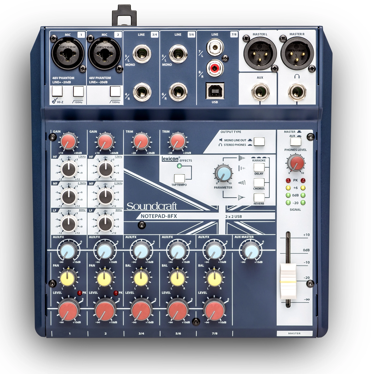

Hi Rafael.
Depends whether you want to be able to mix or not, but I can mention a couple of good value products.
My brother wanted to be able to mix his computer's USB output with line level sources and ended up buying a Soundcraft Notepad 8.
There was a time when buying a cheap little mixer wasn't a great idea in terms of quality. The worst gave you hum and hiss in with your music. Things have changed a bit though, Soundcraft is a good make and these little units come at nice prices - though if you're going to be into DJ games you might just prefer one with slide faders.
Alternatively, for just a USB source and no mixing, this could be good for you:
It could be used as a preamp (using its front volume control) into your power amp.
Either option would give you the headphone output you need too.
I believe your Chevin only has balanced inputs. Both the above give the balanced outputs you need. The Soundcraft uses conventional XLR connectors.
But the Zen uses a Pentacon connector for its balanced output - not yet common, so an adaptor lead would need to be tracked down from somewhere (or you could obtain a Pentacon plug and make up a lead to XLR youself). Failing that, you could use its unbalanced (RCA) connectors, with the appropriate (RCA to XLR) lead.
