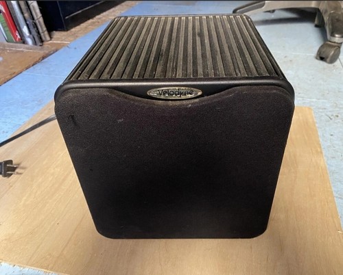

second-hand Rels, Velodyne's, Micro vee's (Velodyne) come up quite often and might do the trick and fit the bill assuming you don't mind second-hand and isn't to small. Liked my Velodyne is was a little powerhouse for its size.
