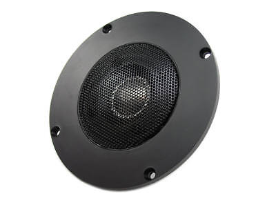

The tweeters themselves are JBL 050 Ti, but I've not yet found any more information about them.
The only information you need is whether you can buy a couple of new ones.
I reckon there are 3 possibilities with that previous owner:
1) He was one of those strange people that see no harm in using tone controls - set to maximum.
2) He was using an underpowered amp - and running it into clipping, causing overheated voicecoils....and the result you've inherited.
3) He enjoyed listening to test tones as much as you do 😉
Contact JBL, Harman or whoever currently owns them about tweeter availability.
Just ensure you reconnect with the correct polarity.
They might have different sized tags for + and - (in which case you can't go wrong).
