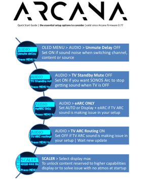

I'm not familiar with the HD Fury Arcana, but I am using a similar non-brand generic digital HDMI/USB C/Optical/Coax monitor adapter that allows me to switch between my home desktop and work laptop, it works to Samsung's monitor max settings 2K @ 240hz without issues.
Unfortunately my cheap adapter isn't compatible with Sonos Arc so I can't suggest an alternative.
Below is link to their online manual. Hope this helps.
When you say you've done the firmware update, was it for all three devices, Epson, Apple TV and Arcana?
So - got CEC working properly, but lost sound to the Arc ... reset Arcana and back to square one - sound to Arc, but no power on CEC. Will start adjusting individual items in the menu and see if trial and errror can narrow the fault down.
