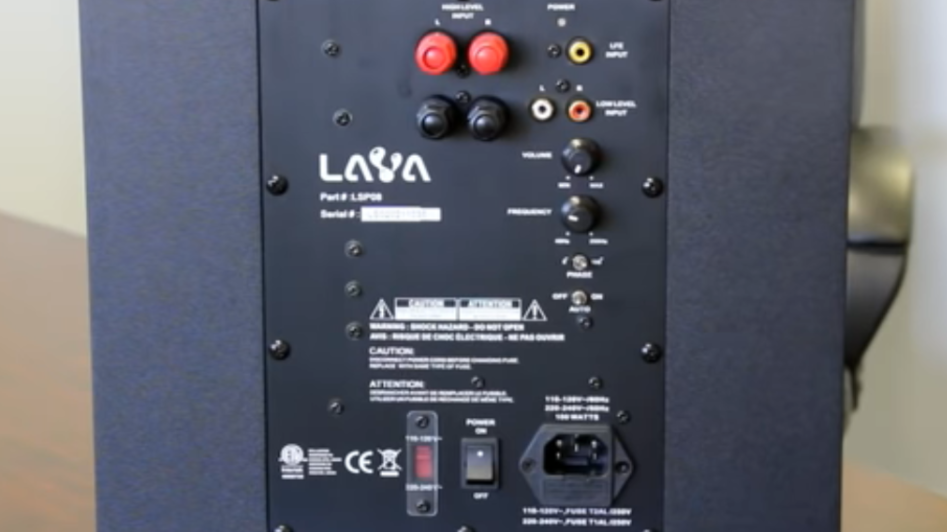

LFE connection
Connect the LFE input of the subwoofer to the receiver using an RCA cable. This is the easiest way to connect a subwoofer with the sound system and it does not even require manual fine-tuning of sound and crossover. However, not every woofer supports LFE inputs.

Low Level Input connection
Alternatively, you can connect the low-level input of the subwoofer with the receiver using two RCA cables.

Connect speakers to the subwoofer
Another alternative way to connect the subwoofer to the stereo system is by connecting the speakers with the subwoofer using normal wires.

Fine-tune the sound
If you connect the subwoofer using low-level inputs or directly to the speakers, you can adjust sound, frequency, crossover and other filters from the subwoofer using the corresponding buttons.
