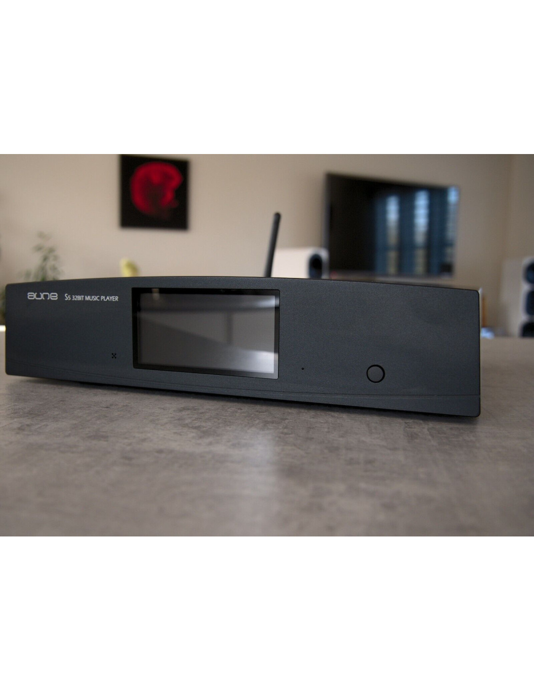

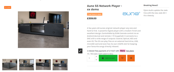

Bill is right but why bother with the laptop?
Get a streamer such as the WiiM Ultra, this is also a digital transport, this will give you a clean signal to your DAC, and will allow you to play all your music files stored on USB or external SSD drive.
Consider also the Aune S5c Network Player Transport (No DAC), this is top notch player. I've seen ex-dem for £359 on Eden Audio. You can also connect your CD player to it via the USB.
Check the link below:
Ps.
Aune are known for their Network players. I have the X5 model setup in my lounge, really nice piece of kit. Check out the other options below.
Ps.
