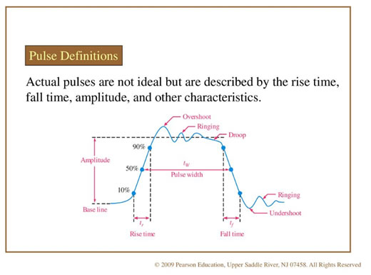

So digital signal over a wire is a block pulse. The signal rises sharply to e.g. 3 V and drops sharply to 0 V.
Of course in real live a block pulse don't exist.
This is how a block pulse might looks in real life.
If this would be interpreted as an analog signal (using the absolute value), this would be a disaster.
The over/under shoot, the rise/fall time, the ringing, etc., all would manifest themselves as distortion.
The moment our interpretation is digital (the electrons remains analog of course), we don’t have these problems.
Despite all the distortions, we can clearly detect the rise to approximately 100% and the fall to approximately 0% of the signal.
As long as we are able to detect this marked change of state accurately at the receiver, we will receive not only the right bits, but will also be able to reconstruct the signal.
