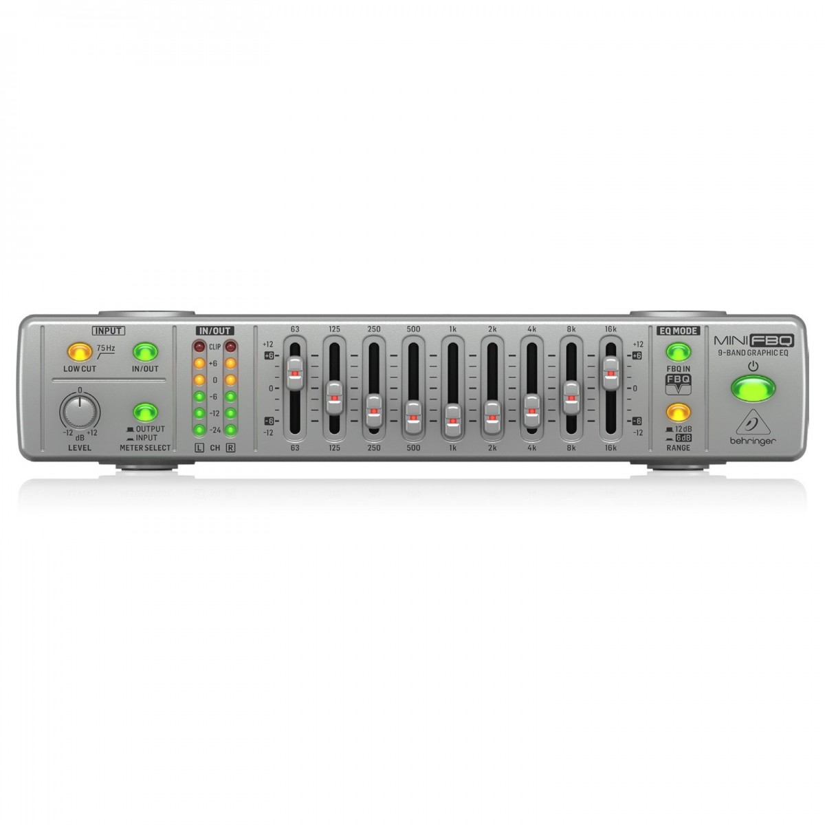

Are there any requirements that i should be aware of when buying an equalizer? Would an older model be acceptable?
That would be the best value one i can find locally - although there seem to be cheaper ones available online
Any advice on what to look for would be greatly appreciated!
Fantastic info, really appreciate it
To be honest - and you may well be aware of this - purists frown upon physical EQ and tone controls in general.
It's true that they can (and do) add some noise to your signal (it's the reason you have 'tone defeat' / 'source direct' switches on amps, to allow for the purest signal).
I used to have a nice Rotel RE-700 graphic EQ....but I wouldn't want to buy something that old now.
In your position, I wouldn't hesitate to buy that Behringer rather than anything cheaper.
On that, you'll be able to accurately adjust your input level to just below clipping, using the LED level meter.
That will maximise your signal to noise ratio.
Also check that the output is below clipping - (your're aiming for unity gain through the equalizer).
You can buy equalizers that independently control your L & R channels, but that one would do me.
(Best to stick to the 6dB rather than the 12dB range on it).
Enjoy what it does 👍
