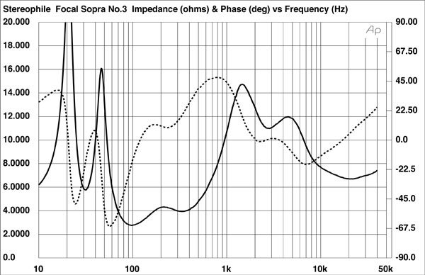

Seems most Focals have this stupid dip in impedance... just saying look at Sopras

It's not that I dont want to. But looking at Aria range it seems the same issue arises. Thats just not good engineering. With Sopra they effectively dip lower than 2 Ohms. And no, trust me your last paragraphs certainly doesn't apply to Sopras if you want them driven properly at reasonable volume. For Arias maybe. It is crazy to have a minimum requirement to spend more on an amp than speakers because of how they are designed.
