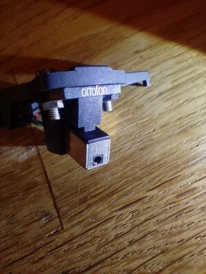

This is what is currently fitted. Also if I remember the stylus was the cheapest I could find at the time
As I said in a previous reply, it is made by Ortofon so you can use Ortofon Stylus, just look on the Ortofon website to see which is best suited. (They don't recommend going above a 2M Red though)
Bill
Looks like Dual DN series. If Bill is correct then any Ortofon OM series stylus will fit. (Forget the 2M Red, that’s from a different range entirely)
Did it look like this?
