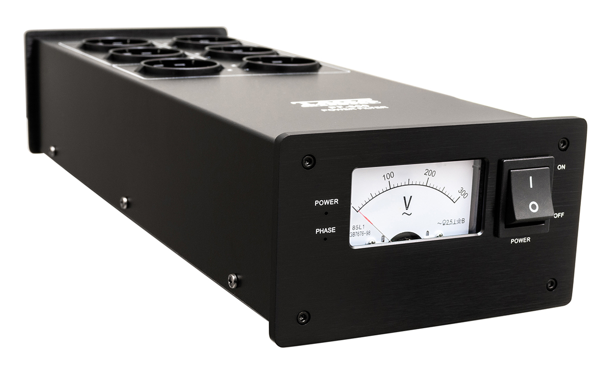

TAGA PF-600 or TAGA PF-1000 V2 could be my next hifi purchase but is it any good ?

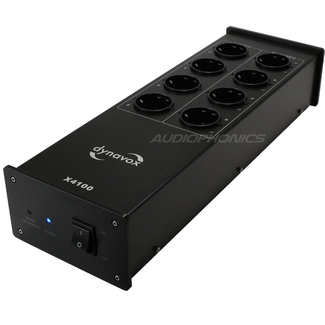

Dynavox makes somthing even cheaper like the X4100 Power Strip
Can they be use with a normal hifi power mains or do they have to be used with a 10a or 15a power cable ?
It depends on the total load of your plugged in components.
Just add together the quoted wattage of all of them then divide that figure by the mains voltage in your country.
A 5 amp lead is likely to be more than enough to cover it.
(That X4100 has its own 10A trip - so no point in using any lead rated above 10A to supply that).
It's just that i only have regular hifi power mains,cable, nothing i know is 10 or 15 amp certified
I know the targa units up to a certain size don't come standard with a power cord
So long as the cable you use has a rating at or above what the appliance is rated at, then that is all you need. (You don’t need one that matches the appliance exactly so long as its rating is equal or greater)
Personally I would avoid conditioners and just stick with anti-surge extensions, or if you are really worried about the mains go for a mains re-generator, this is because the more you put in a circuit, the more chance there is of a fault occurring and is thus not clever with mains voltages.
Avoid expensive fancy cables (Unless you are going for looks) as they make no difference to the equipment. (Plus if you open most of them up the cheap tat that is inside them is worse than something you get from the pound shop)
