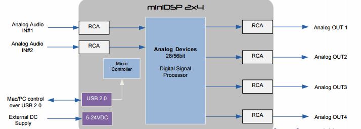

As for the integrated crossover I have no clue how usable it is. Might be crude like you say, which is why I asked if this is an option for Andrew at all.
