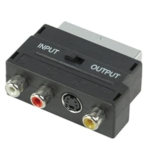

If the TV doesn't have an analogue audio output, you can usually get sound out of it using the Scart socket: you'll need an adapter like this:
Set it to output, connect normal stereo interconnects to the red and white sockets, and the other end of the interconnect cable to a spare input (AUX or whatever) on the amplifier. And no, you won't need a DAC.

Thanks for that, I will go and look for one of these. Would it be called a SCART to Phono adapter or something like that?
