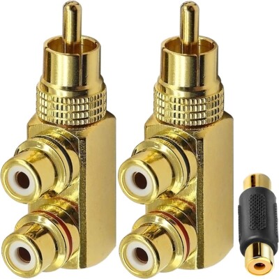

Lol, Looking at that I wouldn't waste my 3 quid.
Seriously, would a better quality version of that work?
Audioquest do one but I'm not convinced.
Maybe this one ?!
Reactions: Gray and Obelix
Why not? Fwiw, we use these Y splitters with JL Audio (the worlds best and the Formula 1 of subwoofers btw) and their subs such as the Fathom f212 v2 @ £7499 and the Gotham g213 v2 @ £18699. Bottom line is if these Y splitters are good enough for a sub such as a Gotham g213 v2 then I think it’s perfectly fair to say that these Y splitters will also be more than good enough for your SVS subwoofer.

Thanks for that, I wasn't trying to be flippant, just surprised at the price compared to what I paid for the interconnects!
To be honest, despite hours of searching the web I hadn't actually found anybody that has said it's ok to just split the pre amp output.
Thanks.

For peace of mind, go for those fully screened ones that @SR-91 has linked to.
There will be no risk of harm by paralleling the pre outs.
You will be altering impedances seen by all - so there is the (theoretical) chance of altering sound.....but you will be able to judge whether you've compromised it.
If in doubt, don't do it.

I'll order some screened ones and see what happens.🤪
Thanks for your help folks, I'll report back when it's up and running.👍
