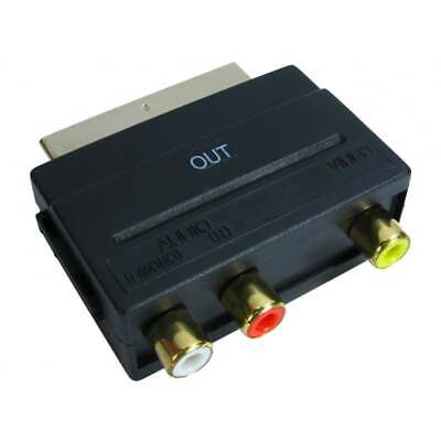

Not even sure how a Scart lead would help unless you have a satellite box - never seen amp with Scart connections.
The TV has the SCART socket. Fixed line out was always available on 3 of its pins.
This gets it (via twin RCA cable) to your amp:
