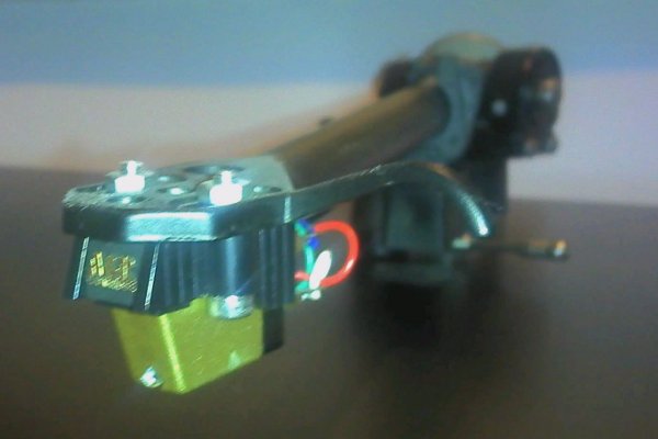

I've inherited the above turntable (UK), but it seems to be missing the cartidge and am at a loss as to where to begin identifying what would be a suitable replacement.I can't see any identifying marks on the arm. The head seems to be branded A&R Cambridge and looks like this:
Any pointers appeciated! Cheers,
Rich
nopiano
It looks like an A&R C77 or E77, but I'm sure someone will know for sure.
I believe they have been discontinued.
Depends on your budget, but Ortofon 2M or Golring 2000 series seem popular. Grados sound nice but some say they hum in Regas.

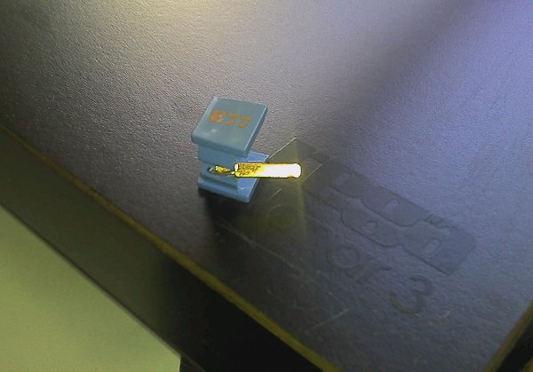

I remember now the stylus (E77) somehow got bent (cleaners?) and I'd removed it to take it into a dealer for them to match it:
The question now is whether to try and hunt down a replacement stylus or upgrade to a Ortofon 2M :)
it looks like youre in the same boat i was with my plannar 3, bought it off ebay and it came with the same cart (i think they were regularly sold new with them) but the connical stylus. sounded quite good but i think you might as well upgrade the cart because you cant get replacement styli as far as i know and it would cost more to retip it than i would bother spending. i had a very quick look on Jico but i couldnt find one there unless its under a differnt name.
i looked at the AT-440mla at first but ended up getting the Goldring 2400 (i ordered the 2300 but got sent the 2400, which was very nice of them) cant tell you how good or bad a choice it was as its my first TT but it does the job good so far.
