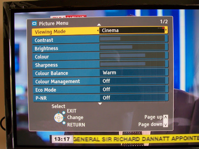

Here goes
This is from a panny BD-35. At first i thought the colour can't be right, but watched the demos on DVE and watch Troy and wow. I hate oversaturated colours, but this is so right. I only use this setting on BD, everything else (Sky HD and Freeview is done by eye). Note during calibration I noticed green was slightly out.
Thanks Pippi. The settings are radically different from mine (and from the 45% brightness, 65% contrast, etc, settings recommended by WHF). However, I changed the settings on my G10, to approximate what is shown in your photo, and it genuinely seems to have made a difference in several respects. First, the picture via freeview seems a lot more stable and noise is dramatically reduced. Second, colours don't look oversaturated, surprisingly, though my setting isn't quite as high as yours. I'll leave these settings alone and try with a range of sources to see how I get on. Appreciate the post!
