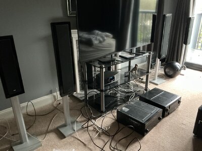

This is what I am currently playing about with:
I am getting the Wiim Mini today too.

Cool, thanks. Should be coming in the next 30 mins. One problem I am having is connecting the subwoofer on the Pioneer VSX-LX70 amp with stereo or just in general too, it doesn’t seem to want to work! I have tried a few things now and still no luck. I don’t particularly want to buy another amp as I would like the money for another sub preferrably.
I have been thinking about floorstanding speakers though in the past and now I have these 2 speakers which are equally up to task. I will see how things go with getting the sub connected first.
How are you connecting the sub? Have you run calibration on the amp?
Connected the sub to the back of the amp. I run the calibration settings last time on the amp but couldn’t get the sub to connect, I think I need to try again. Thanks BB. 👍
I can’t get the sub to connect when setup the speakers with the mic for calibration. It’s only coming from left and right and not the sub? Also with this Wiim Mini device the speakers are distorting when first coming on and I am not playing music there is a distorting sound coming from the speakers? Any ideas here?

Have you set the Amp setting to sub on? you have a choice 1 or 2 subs .
No. How do I do that? I think I need a new amp, it’s distorting with the Wiim Mini device connected to it without it isn’t. It’s a very old amp and it’s really complicated to use. It’s not like the modern day ones. Any suggestions on amps for this 2.1 system project?
you dont need a new Amp how are you connecting the Wiim best way is optical.
you need to go into Amp settings and look for Sub woofer then choose on .

Ok, thanks for this, I will try optical and using the subwoofer with the manual instructions. I will let u know how I get on, just need a coffee first. 🙂
What optical device to I plug it into on the amp? Thanks.
the Wiim into the Amp then choose optical on the remote of the Amp
The sub lead directly in to the Amp .but you must turn on the sub setting within the Amp to ON.If the sub has a volume on it set to halfway.
I just got a connection via tuner and it’s still distorting?
if your using the Wiim App you must choose optical out on the Wiim App
Yep, got optical output on the App, just did auto.
I can’t get the sub to connect though, I re do the calibration and it’s only recognising left and right when that process is finished I try going into the menu to try and set the sub on which I did but I didn’t manage to save it, now I can’t find it again!
its there you just need to find it press yes then return on the remote
