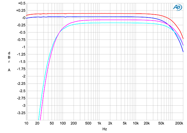

I think it might be an impedance missmatch that affects the low bass. I'm looking at these measurements in the AR review by Stereophile.
Do you mean the raising of the Impedence through the introduction of the attenuators is killing the low bass or are you talking in general terms about the setup?
Seems to be. The AR is quite sensitive in that region with impedance matching, as per John Atkinson's conclusion in that review, not my own. By adding the attenuator with just few hundreds of ohms impedance, you may have made the frequency response slope by few dB in the bass area. How much ohms is the attenuator specified?
