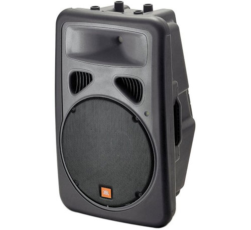

When you need a good sound wallop for a private party or just simply to rock out, those CVs are you best bet. I also had these JBL Eon 15 to get my kinks. But those fun days are over.
Now, if you want large SPL with accurate,undistorted fullrange sound with fast transient response... that is not going to be cheap.
