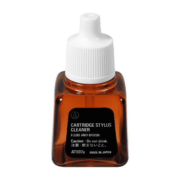

I still like isopropyl alcohol for cleaning, though it’s less fashionable. Probably because it’s cheap. The classic Audio Technica bottle and brush is still good value and should last years.
That's £1300 per litre! Isopropanol can be had for less than a fiver per litre on Amazon and, useful for much more than just stylus cleaning.
EDIT: From an Audio Technica pdf, "Ingredients: Water, Ethanol, Isopropyl alcohol, alcohol propyl-n. "
So basically, water and alcohol.
Yes, it’s an expensive way to buy the raw ingredients, but the ‘added value’ is the included brush, the handy-sized bottle, and the reassurance that it’s come from one of the leading cartridge manufacturers. And it’s much cheaper than pot of goo that needs careful handling to avoid wrecking your stylus.
