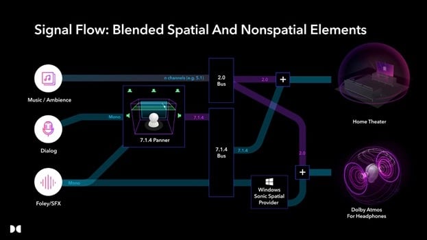

Dolby Atmos for Headphones
Dolby Atmos for headphones enables sound to come from all around the player, including height, through any set of stereo headphones. It uses a technology called a HRTF processing (Head Related Transfer Function) to give the listener the perception of hearing sound sources around their head. It does this by modelling the time difference between sounds hit either ear, and the acoustic shadowing caused by our pinnae (outer ear), head and torso.
When the bed channels are virtualized for headphones using Dolby Atmos for Headphones, you could think of them as virtual speakers arrayed around the listeners' head, using binaural processing (HRTF filtering) to place each virtual speaker in space around the listener. Sounds are panned around the virtual speakers in the same way they would be panned around speakers in the real world, creating phantom images between the virtual speakers.
Individual Dolby Atmos objects are processed with their own HRTF function, increasing the spatial accuracy compared to playing in the bed channels, which uses phantom imaging panning between the virtual speakers to locate sounds in 3D space.

Thank you for this detailed explanation of atmos for headphones. Am I right in thinking the only way to enjoy this is via a computer on with the atmos for headphones software? And therefore it is impossible to recreate via Bluetooth? So atmos enabled TVs/streaming devices would not be able to transmit Atmos to wireless headphones?
You're mostly right, but there are some nuances. I found this:
1. Dolby Atmos for Headphones Works via Software Processing
  • The only way to experience true Dolby Atmos on Bluetooth headphones is if the device (PC, console, phone, or tablet) processes the Atmos effects before transmitting audio over Bluetooth.
  • This means Dolby Atmos for Headphones software (like Dolby Access on PC/Xbox) or built-in OS processing (like Apple’s Spatial Audio) is required.
2. TVs & Streaming Devices Can’t Transmit Dolby Atmos Over Bluetooth
  • Standard Bluetooth audio (A2DP profile) doesn’t support multi-channel Atmos metadata.
  • Atmos-enabled TVs and streaming devices (Apple TV, Fire Stick, Nvidia Shield, etc.) only transmit Atmos via HDMI (to soundbars/AV receivers).
  • They cannot transmit Atmos audio over Bluetooth because Bluetooth lacks the required bandwidth and codec support.
3. Workarounds for Wireless Dolby Atmos on TVs
While TVs can’t send Dolby Atmos over Bluetooth, there are a few alternative ways:
A) Wireless Headphones with a USB Transmitter (Non-Bluetooth)
Some wireless gaming headsets (like the SteelSeries Arctis Nova Pro Wireless or Razer Kaira Pro) come with a USB transmitter that allows them to receive Dolby Atmos audio without using Bluetooth. If your TV supports USB audio output, this can work.
B) HDMI Audio Extractors + Wireless Transmitters
  • Some HDMI audio extractors can take the Atmos signal from the TV and send it to a dedicated wireless transmitter (e.g., RF or Wi-Fi-based, not Bluetooth).
  • This is not ideal for most users but is technically possible.
C) Apple’s Spatial Audio with Apple TV + AirPods
  • Apple TV 4K can process Dolby Atmos and send it to AirPods Pro/Max via Apple’s proprietary wireless audio (not standard Bluetooth).
  • This is an exception, as it bypasses Bluetooth’s limitations using Apple's ecosystem.
Bottom Line
Dolby Atmos for Headphones works with PCs, Xbox, and compatible phones because they do the processing before sending audio over Bluetooth.
Dolby Atmos-enabled TVs and streaming devices cannot transmit Atmos to Bluetooth headphones—they need HDMI or proprietary wireless connections instead.
If you want wireless Dolby Atmos from a TV, you’ll need AirPods + Apple TV, a headset with a USB dongle, or a more complex HDMI audio extraction setup.

Thank you so much for this comprehensive explanation. Its what I have been looking for online without success and confirmed what I was thinking. Really appreciate you taking the time to present the information so succinctly.
