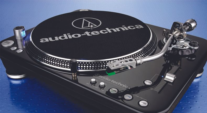

I'm a vinyl enthusiast and I live in Brazil. Here the information is very scarce. My intention is to listen to vinyl records and I currently have a Marantz PM8006 Amplifier, Elipson Prestige Facet 8B speakers and a Turnable AT-LP1240 with Ortofon 2m RED.I want to change my capsule, I wanted to buy an ortofon 2m black. However, I was unsure whether I should also change my AT-LP1240 since it is more aimed at DJs (I didn't really understand this at the time I bought it).My question is: Should I actually change the AT-LP1240? I thought about purchasing a Raga Planar 3 or Pro-ject RPM 3, or perhaps even a Pro-Ject 1Xpression. Is changing the record player really recommended? Should I really get another sound experience with better quality for my purpose?I already know the cartridge is terrible and should at least go to an Ortofon 2m Silver!Thanks to anyone who can help!

You have the same issue with your AT1240 as I have with my PLX1000, they are both mass-produced Chinese Technics clones without the original Technics quality. They are reasonable decks and can sound great with the right cartridge on them, but what they do lack is the quality of better brands as they are just churned out with different names on them - Reloop, Stanton, AT, Pioneer, etc., with very questionable QC. But they do feel far more substantial than the more lightweight Rega and Project offerings.
It really doesn't matter matter what the drive system is as long as it turns a record at the right speed, and everything is within spec. However, tonearms and cartridges play the biggest role when it comes to performance, this is where brands like Rega an Project generally excel.
Personally I'd keep the AT deck for the moment and either either stick a 2M Blue stylus on or a complete AT VM95ML cartridge and see what you think, AT cartridges are very good (y) I am unsure about Nagaoka prices in Brazil but they have become very expensive over here and face stiff competition.

I would say yes, your AT, like any turntable, will improve with a better cartridge.
When I had my Pro-ject Xpression 1, which cost £200 new, I had a £130 ClearAudio cartridge fitted and it gave me an impressive uplift in sound.
Just for the record (excuse the pun) I've also owned a Ortofon red that doesn't compare with any of the Clearaudios or Goldring carts I've owned.
record_spot
The AT1240 is absolutely fine - I had a later derivative of it under a different marque and it was a great deck.
Previously, I'd had a Rega P3 (from 2000) and while it was a good turntable, you were paying for the RB300 tonearm and the Elys 2 cartridge. A glass platter and MDF do not clock in at high bucks.
Stick with the AT. Buy a better cartridge - but check capacitance before you do as this is a major factor - I used an AT-VM95ML. If you can stretch to the 540ML so much the better.
I liked that you could adjust the height of the tonearm assembly, build quality was great - solid as a rock, so playing stability was excellent. The tonearm assembly was fine too. I later was swayed by a modded TD160 with a hefty plinth....but the AT variant was the better deck.

I will try fistly change my cartridge... VM95ml or VM540ML... I think that i can buy here in Brazil boths for a good price
