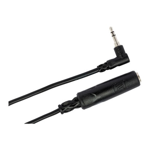

I would be looking for a similar, stereo, right angled 3.5 plug to socket short cable, if I were you. (Otherwise just be physically careful when using straight adaptors with your Chord).
EDIT: a brief look found the one below - couldn't see mention of the length but I'd be looking for a gold plated (and cheaper) version anyway:

Cool, thank you! It looks like that product had mono: "These mono headphone adapter jack"; I recall the plugs being stereo (2 stripes) for these headphones, so will this adapter still work?
Apologies - I hadn't noticed they were mono as most jack plug for hifi use are stereo. Try these instead:
They are stereo, not mono.
