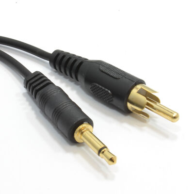

Any suggestions for a decent digital coaxial lead that will connect my WiiM Pro Plus to my Chord Mojo. I thought I could use RCA size plugs, until the mojo arrived today.
DO NOT use standard RCA to 3.5mm cables. You can get coaxial standard to 3.5mm cables.
A coaxial cable is a cable with both conductors sharing a central axis..
The cable I linked to is a coaxial cable
It will work.
You're thinking it looks too cheap.
Yes a 75 ohm coax cable is the theoretical ideal - even then, an RCA plug is not a genuinely 75 ohm connector.
But the chances are there will be no audible difference.
If it was me, I would probably get some 75 ohm coax and fit my own plugs.
But if you can find a genuine 75 ohm RCA to 3.5 mm cable I want to see it. (You won't be able to).

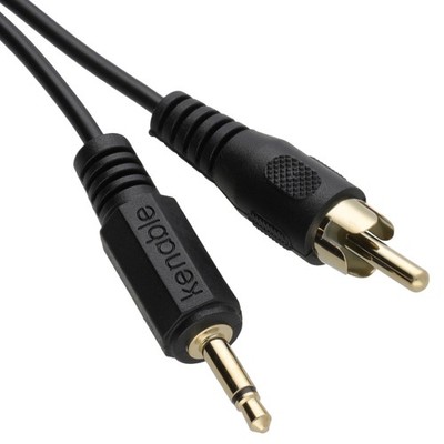

I have a WiiM mini so have never seen a pro plus in the flesh. Just googled it and zoomed in on a photo it is an RCA, so you will need RCA to 3.5 (also sometimes called mini jack).
I have been down a Google rabbithole and found others have had the same problem. There are very cheap cables that they don't trust, and very expensive ones. I did find this one that the marketing blurb says ideal for Chord Mojo:
No idea how good they are but you could give it a go if not happy with the adapter.
