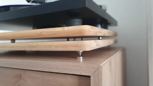

Cheap Hack 2 off IKEA Aptitlig bamboo chopping boards as a isolation Platform with 7/16inch ball bearings
chopping board has a shallow rounded channel routered on side. The channel is there to catch liquid
2 chopping boards, with the channels facing each other and ball bearings in between, to make a isolation platform under the TT, if you dont have any ball bearings try a semi-inflated bicycle inner tube

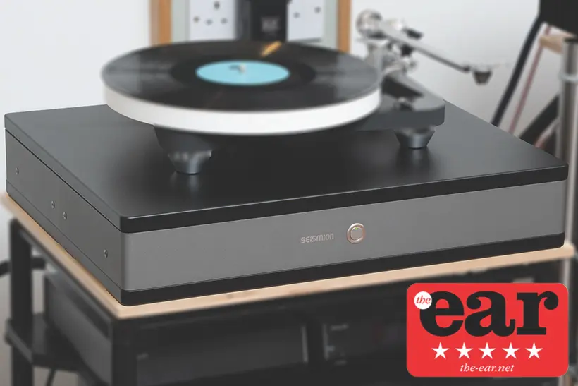

Have a Rega Niad with a electron microscope isolation platform
Not Cheap But huge improvement in Sound
