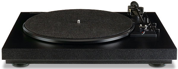

If you think your girlfriend might appreciate a fully automatic TT, then you might want to put this new Pro-ject on your list.
Possibly bit more than your budget, but includes the cartridge and built-in phono pre-amp.
Here's a review:
