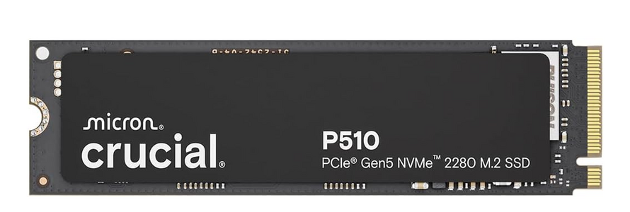

Get something that would last, had a quick browse. You can find cheaper but better to veer towards the better brands than the generic stuff. All the best 🙂
Check the Amazon links below.
Or without the thrills and cheaper, same as mine - below
You don't need Gen 5 but this is going to give you the fastest speeds, backwardly compatible with Gen 3 and 4.

Perfect, thanks. 🙏
Thanks Sam, it is the cache.
Cheers Sam, I do have two Sandisk products, a flash drive and an Extreme SSD, I always prefer to use decent brands, the one I’m using now seems oddly to be better or at least more stable, but hopefully the suggestions made here will help moving forward.
Thanks again guys 👍
